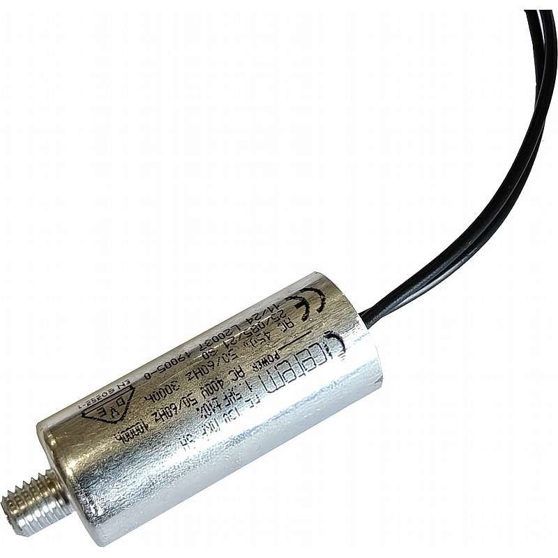

In that case it can very well be the capacitor.
I never opened the case of the feeder auger (that one part never broke...) so I not sure what type of motor it is. Since it is a single phase AC motor it can only be of two types, either one similar to the fan motor
http://www.pelletsbutiken.com/86-thickb ... x-20kw.jpg, which does not have a capacitor at all (the thick copper wire that runs through part of the stator fills the same function, sort of) but that's a bit unlikely. The more likely motor type requires a capacitor either looking like this:
http://www.pelletsbutiken.com/sv/kmp-ka ... or-k6.html or like this
http://www.hedestoker.dk/3631_500_konde ... scotte.jpg, to start. It should be easy to replace yourself, unlikely but possibly requiring a soldering iron, but you of course have to find a matching one.
Even before switching capacitor I would check with an ac-voltmeter that there is 230V at the feeder connector when it should be running, to rule out some kind of intermittent fault on the circuit board.
